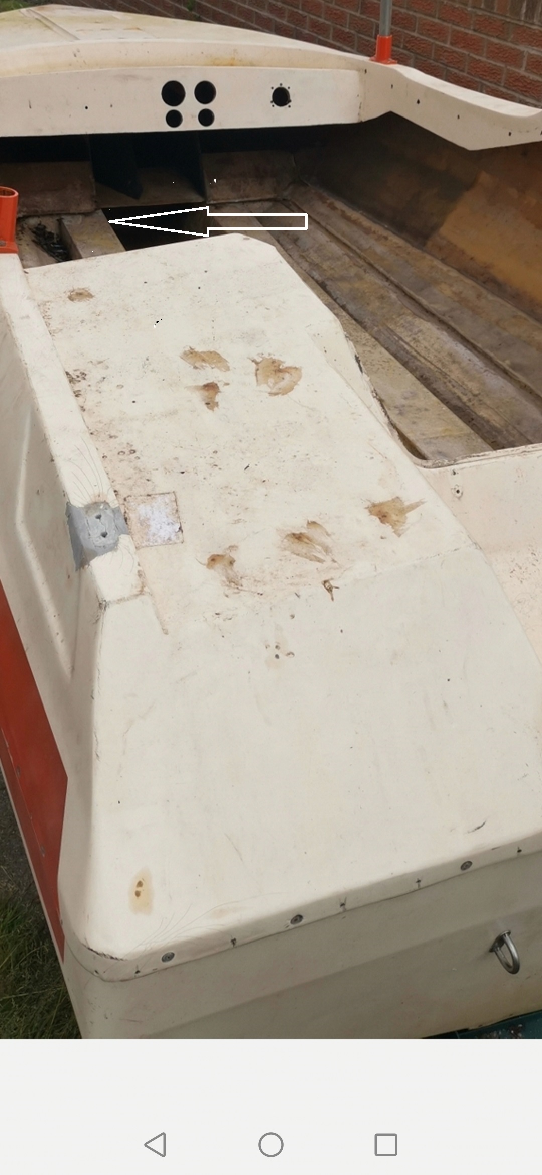

by Sean2904 » 29 Jun 2020, 09:32
Thanks for your reply.
The problem we have, however, is that there is no floor. I've attached a photo, which is the best one I have at present, (but can take a better photo of the inside later on) and if you can make it out, there's just fibreglass casing. I sanded a bit of the glass down to break through and see what was inside the form but there appeared to be no wood under the glass. There was, however, a small pool of water formed inside which we will need to work out how anything is getting in.
The boat has been sitting in storage for a good few years from what I know so I'm hoping that the water is sitting in because of an exterior crack or hole rather than anything underneath

by Ianfs » 29 Jun 2020, 22:10
Hi Sean
Thanks, from this photo there is no floor and I have to say it looks pretty dry which is pretty good and I suspect is fairly solid. The arrow on my picture is pointing to one of the stringers I was talking about.
This box section looks like a 4"x 4" section of wood laid along the length of the hull on both sides. It would be amazing if this were a 4x4 piece sections as this would be an extremely strong hull for a small sports boat, My feeling is that this is either a box section of ply covered by fibreglass or several pieces of ply sandwhiched and covered by fibreglass.
As you have it all exposed at the moment I would absolutely take samples from them. They can be replaced with plugs and epoxy so no strength issues. But if any of the samples are wet you will be able to drill the HAT take the rotten wood out and fil with epoxy.
