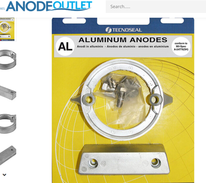

I have been using Aluminium anodes over a period of at least 10 years with no issues.
They must be popular otherwise retailers would have given up selling them.
Any thoughts why zinc and magnesium are needed ?
Screenshot 2024-03-17 22.48.02.png (469.35 KiB) Viewed 23107 times
