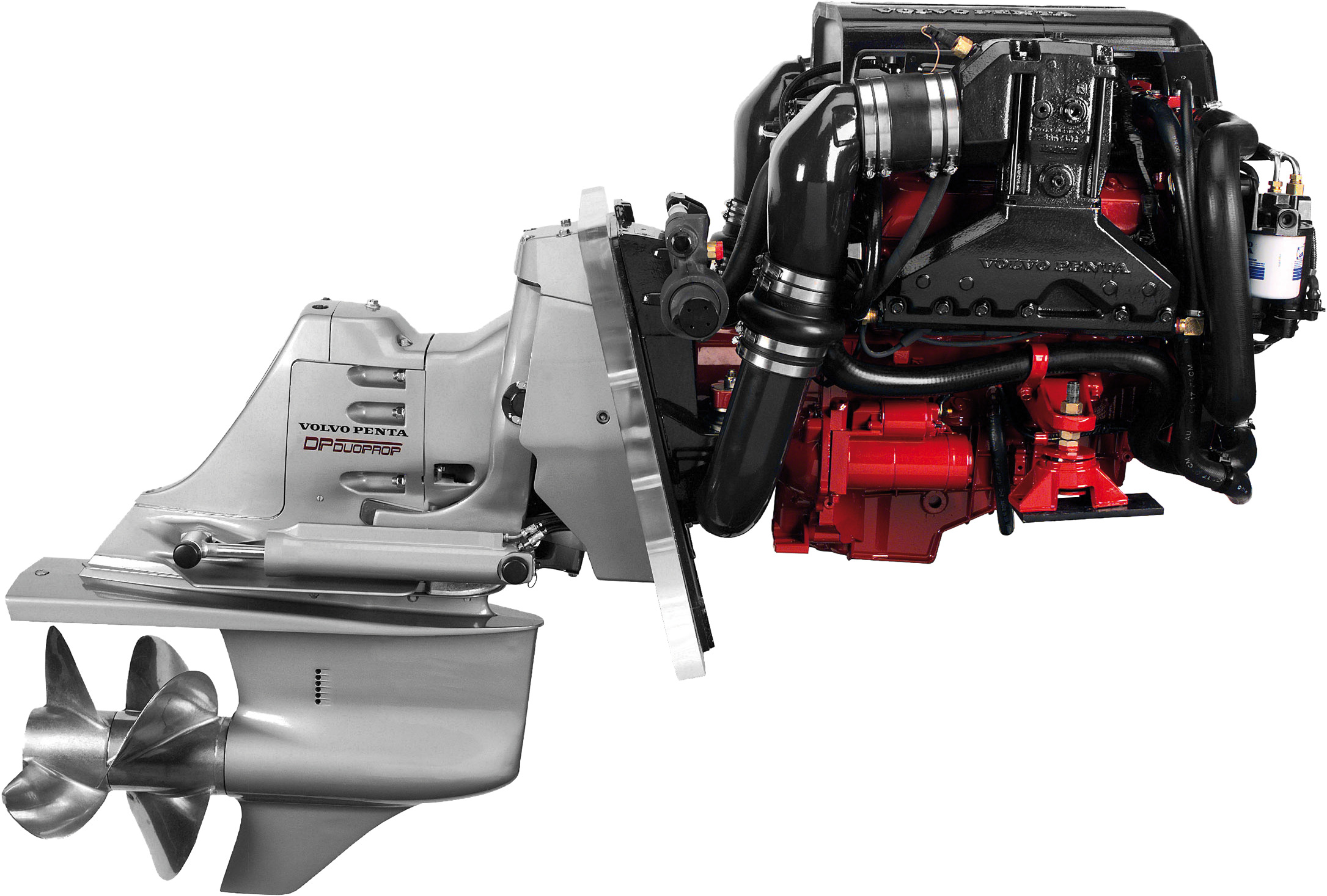

I have a FourWinns with a 280hp Volvo Penta with Stainless Steel DuoProp outdrive
Boat delivered in June 2020 … used first season, no issues other than needing prop changed to alternate pitch set.
Did first full season in 2021 … very pleased with the DuoProp it provides a massive increase in torque, over single prop, and many other benefits.

…. Towards end of last season I noticed some bubbles in the paint immediately after the prop (bearing carrier)
Reported it to dealer … no worries we will record it and can be dealt with end of season.
OK in Oct booked the boat in for annual service & sorting out of corrosion.
They examined and found significant corrosion on drive, near the props.

Collected my boat, Contacted another VP dealer … this time 100 miles away …. Take boat in, they examine, confirm corrosion … plus additional corrosion on transom shield & particularly around hydraulic rams … assumed to be some issue with Earth bonding allowing electrolytic corrosion … Bonding especially important due to significant amount of stainless props …
but as never moored unsure why it’s having this impact.
VP wanted full examination .. and to be 100% clear they stated this is fully covered by warranty, and they have decided to swap out the complete drive including the transom shield, as this also needs engine out …. a significant job.

No cause.
Initially they were sure it was galvanic corrosion, and were talking about incorrect mooring hook up....when I pointed out boat has never been moored.
No mention again.
When it goes in in Jan I will ask them for a report of why it failed.
Big blister bubbles under paint esp near prop. As prop is SS I suppose it could well be galvanic if Transom shield & drive not earthed properly.

I thought their new drives have an ACP (Active Corrosion Protection) system which is similar to a Mercathode on Mercruisers. As far as I know, it works via the on board Electronic control system and is powered by the Aux battery. But I think it also has a back up Zinc anode. However, as we all know, these only work when in water, but as your boats are always flushed and rinsed its very odd to have galvanic corrosion when yours is always stored under cover on land.
Yes, it's possible that maybe that one of the straps was not connected correctly which would mean instead of a protective current to the drive, galvanic action would take the most sacrificial metal, but I am shocked it would happen so fast having been in salt water for such a short time whilst being rinsed thoroughly every time.

No ... as standard just earthed connections and sacrificial anodes.
The Volvo Active Corrosion Protection, 1 an add-on and advised not needed for trailered boats ... main benefit is when moored.
Particular issue with stray currents from other boats.

The problem I saw was bubbling of paint around the gearbox near the prop …. VP refer to it as the bearing carrier.
When they did full inspection they found the paint was bubbling on both rams and on the bottom of the transom shield.
Incredible amount of corrosion on a drive that was not moored and only 30Hrs on the clock.
The comments from the dealer were they thought there was some continuity break on the earthing …. and the big mass of stainless DuoProps then caused electrolytic corrosion.. Next thing was, ‘we are changing the drive.’
