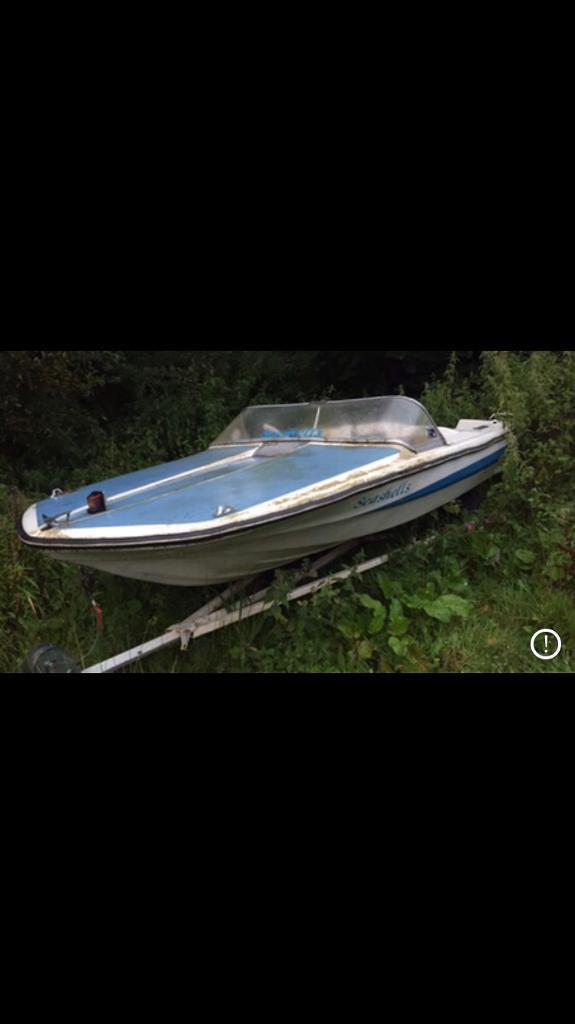

hi all, relatively new to boating. im buying a project boat tomorrow as long as the add was honest and was wondering if anyone could please try to identify it? (pic is attached as JPG file, click on it to view it) it is up for £100 with steering hooked up ready to put an outboard on and comes with throttle and cables as well as a trailer with one new tyre. this seems almost too good to be true thanks in advance,

Hi Josh
Welcome to the forum.
It looks like an old Shakespeare. There used to be a website with the history of Shakespeare boats but I can't seem to find it sorry, must have gone off the air.
It must be worth £100 regardless, unless of course the hull is totally shot to pieces.

I would imagine if it has sat there without a cover on it will be rotten inside personally in which case it then becomes one hell of a project and probably not financially viable? Obviously dependant on how long sat there etc..
Saying that, if the trailer is in useable condition that would probably be worth the £100.

thanks for the replies, i did buy the boat and the trailer is a home made with the axel presumably from an ole robbin relliant with the diff still attached as well as no brakes and no jockey wheel. it weight A TON to lift onto tow bar haha but finally got it home and have given it a good scrub. not bad hull condition at all. the guy who sold it gave me all the gell coat etc needed as he gets it for free from his work (princess yachts). do you think a 20 hp would be enough to get it up to about 20 knots with two passengers?
cant be to bad for a first proper boat being 17 y/o on minimum wage............

20hp is too small .
Min would be a 50 on that.

Check the transom, two reasons:
1. There might be a plate on it stating the maximum rated power that the transom will take.
2. It could be rotten and need repairing

17 years old and on min wage. welcome to the path to stay poor (boat ownership). Your project will be a lot of fun and hard work, but with lots of elbow grease I am sure you will get there. The comments about ensuring that the transom is solid is very important and if you want the boat to perform well as has already been said 20HP is not enough. I would guess that you are close to the Plymouth area (Princess yachts) and with 20hp you could have some nice days out in the sound using the boat as a runabout, but to get the boat to plane well with 2 people and gear on board you will need at least 40 hp (an old ex RNLI Evinrude 2t may fit the bill and your limited budget). Good luck with whatever you decide and don't let anyone dampen your enthusiasm. Geoff.
