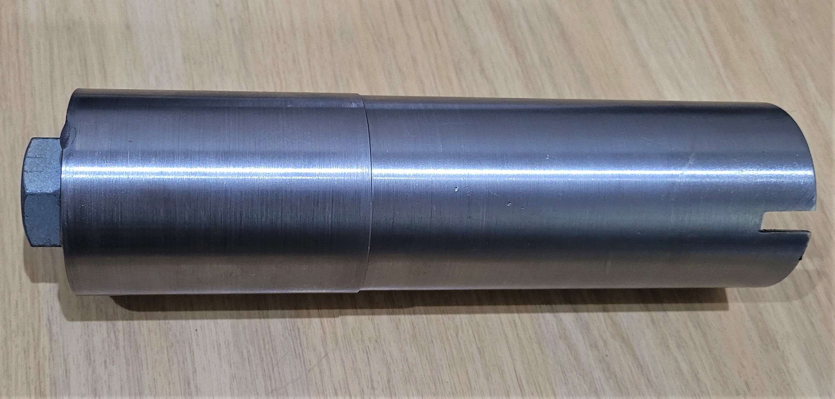

Measurements as below
Inner 52.8
Outer 57.3
Slots are
6.00 approx as they not all the same
by 14.8 BUT they are rounded at the bottom
from Keypart website it is suitable for these. does not look like it will fit yours

by argonaut » 27 Jan 2022, 15:13
Didn't hear back from Ian H ... so I made one ..... bit of 50mm pipe and turned to make it same size, and some hacksaw & filing to create the slots.
Welded a 30mm nut on back ... so same size as nut on the rear prop.
