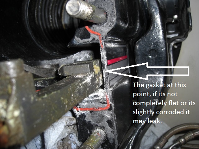

by Ianfs » 12 May 2017, 21:18
Can I just say, I think I understand what you have studied Ian, but Alpha One Drives and
earlier had a completely different upper shift shaft seal/bushing to Alpha One Gen II's.
They were small and unreliable.
They only sell the newer bushings now and the likely hood of a Gen II leaking is remote,
the newer seal has 3 seals within the brass bush and is much less likely to leak.
Having said all this, as with any leak, imho...if you suspect an issue its always best to
change it out. However if you have a leak into this area, I would suspect the gasket
between the drive and the bell housing at that point....When you tighten the drive
nuts, very often the gasket squeezes out a fraction, it's such a small strip for the
gasket to squash in, it may go one way or the other. A good dollop of
Marine Silicon will stop water intrusion.
by betty boop » 13 May 2017, 10:36
very good Ian you are spot on. If I may explain a little - initially my diagnosis was the gasket
but then after completing the job (by pure chance) I read many online reviews on the
Gen 2 seal failing and causing the leak. Yes Gen 1 was unreliable but Gen 2 apparently
are also prone to failure (although having owned one for 12 years now I haven't
personally experienced or heard of this)
funny you should mention silicone on the gasket at that area you highlighted
- when I refitted the drive with black marine gasket sealant + gasket I noticed
the new gasket fitted would not sit between the 2 drive section at the shift
cable chamber . After 3 refit attempts with more gasket sealant added it would
still sit outside the drive. When the trimming knife came out i soon reached
the point of 'Oh Sh@t' and a new gasket was needed. Luckily my spare
(a quality one not a cheap knock off) fitted first time and sealed as it
should AFTER I removed all the gasket sealant. So theory 1 - either gasket
sealant does not work well in that very thin area of contact acting as a
lubricant or cheap gaskets are not worth the saving.
Theory 2 - My belief is the previous gasket also sat proud at this point
(having been 'told' by the dealer it had a full drive service before
being sold) and caused the water ingress but it is unclear how the
water (without exhaust gas pressure) travelled up the shift cable.
